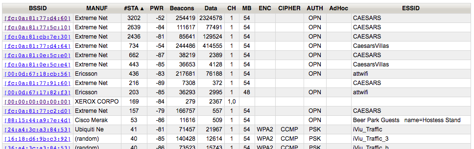

Here is a list of access-points (on channel 1 only) sorted by popularity, the number of stations using them. These have mind-blowing high numbers in the ~3000 range for “CAESARS”. I think something is wrong with the data.

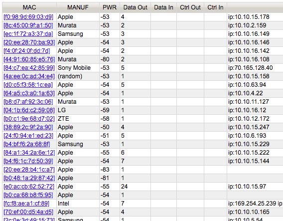

I click on the first one to drill down, and I find a source of the problem. I’m seeing only “Data Out” packets from these devices, not “Data In”.
These are almost entirely ARP packets from devices, associated with other access-points, not actually associated with this access-point. The hotel has bridged (via Ethernet) all the access-points together. We can see this in the raw ARP packets, such as the one shown below:
WiFi packets have three MAC addresses, the source and destination (as expected) and also the address of the access-point involved. The access point is the actual transmitter, but it’s bridging the packet from some other location on the local Ethernet network.
Apparently, CAESARS dumps all the guests into the address range 10.10.x.x, all going out through the router 10.10.0.1. We can see this from the ARP traffic, as everyone seems to be ARPing that router.
I’m probably seeing all the devices on the CAESARS WiFi. In other words, if I sit next to another access-point, such as one on a different channel, I’m likely to see the same list. Each broadcast appears to be transmitted by all access-points, carried via the backend bridged Ethernet network.
