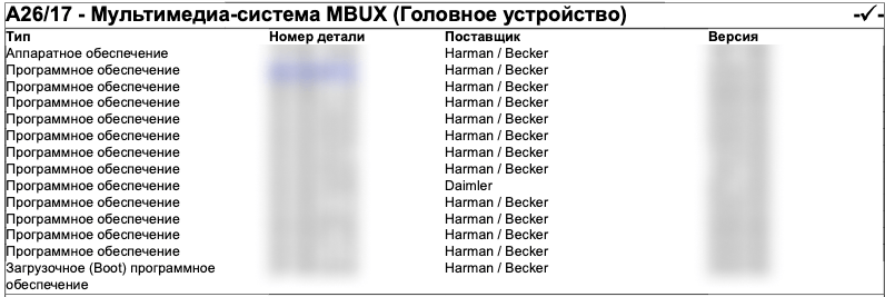

Diagnostic software
To get a first look at the vehicle architecture, it is helpful to use diagnostic software (which is available to certified users only) to scan the Electronic Control Unit (ECU), identify its version, and test the software’s diagnostic functionality. There are several diagnostic tools which make it possible to connect to the vehicle, using various types of communication. In our research, we used a combination of diagnostic tools: a certain hardware interface and a corresponding software application to communicate with the vehicle through the hardware device. This setup allowed us to establish communication over DoIP (Diagnostic Over Internet Protocol):

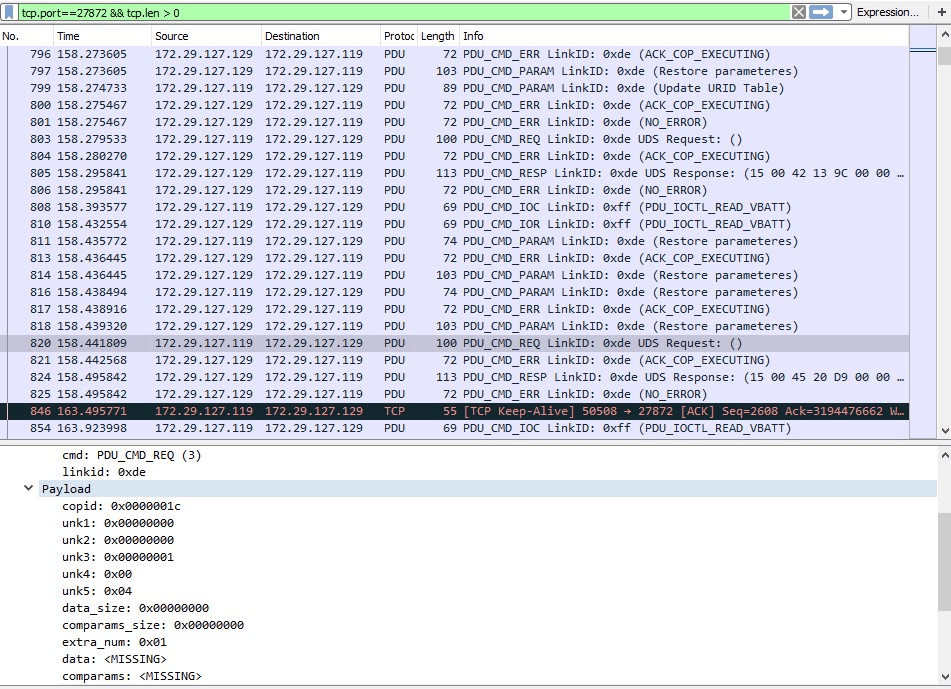

The TCP communication between the diagnostic tool and the diagnostic hardware device is performed over Ethernet using custom protocols (Protocol Data Unit, PDU). At the first stage, the diagnostic hardware device uses a custom ASCII-based protocol (CSD). It performs user authentication, version check, configuration setup, and provides the initial environment to process the upper layer protocol (PDU).
The upper layer protocol has a binary format. It is used to send Universal Diagnostic Services (UDS) messages, trigger DoIP communication, and so on. To analyze this protocol, we used a script written in LUA:
[pduparser.lua]. Using this script, UDS commands can be easily distinguished from the regular network traffic of communication between the diagnostic software and hardware:
We examined the diagnostic tool interface and decoded the traffic, which allowed us to find various UDS commands, such as for resetting the ECU, turning off the engine, and locking the doors.

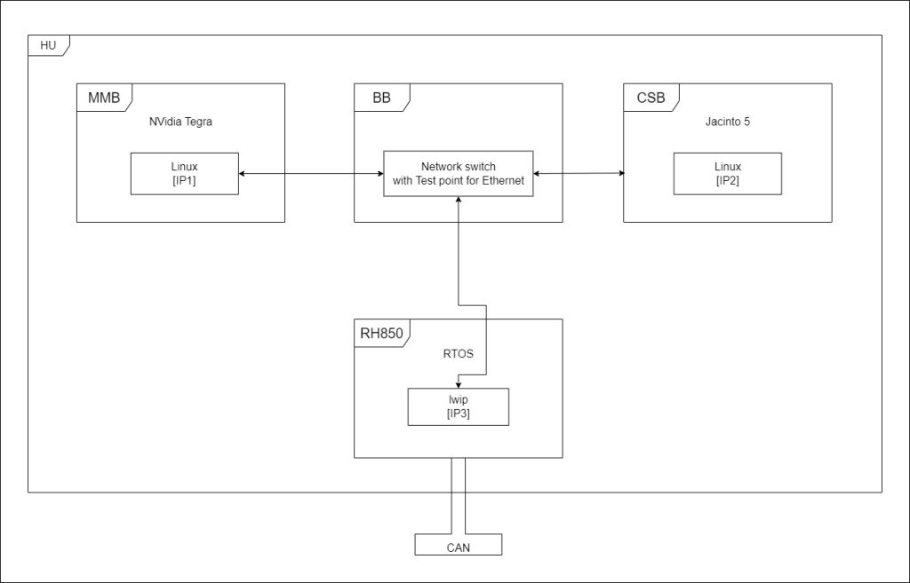

Architecture
The architecture of MBUX is as follows:
The main parts of MBUX are:
- MMB (Multi Media Board) — the main part of the head unit (HU) which contains all the subsystems;
- BB (Base Board) — the part with chips for various network communications;
- CSB (Country Specific Board) — the extended part which communicates with the MMB through internal Ethernet;
- RH850 — the module designed to provide communication between low level buses.
Full information on the MBUX architecture can be found in the KeenLab research.

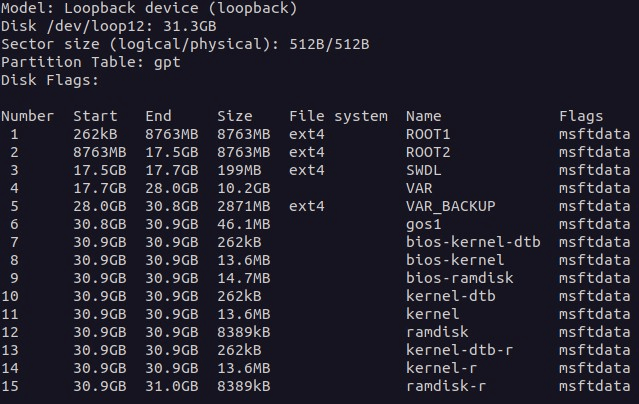

The MMB runs on Linux, and its filesystems are located on the eMMC. We needed to extract the eMMC from the printed circuit board by unsoldering it. Inside, there are several partitions:
MMB files can also be downloaded from a diagnostic tool website that provides updates for specific hardware part numbers.

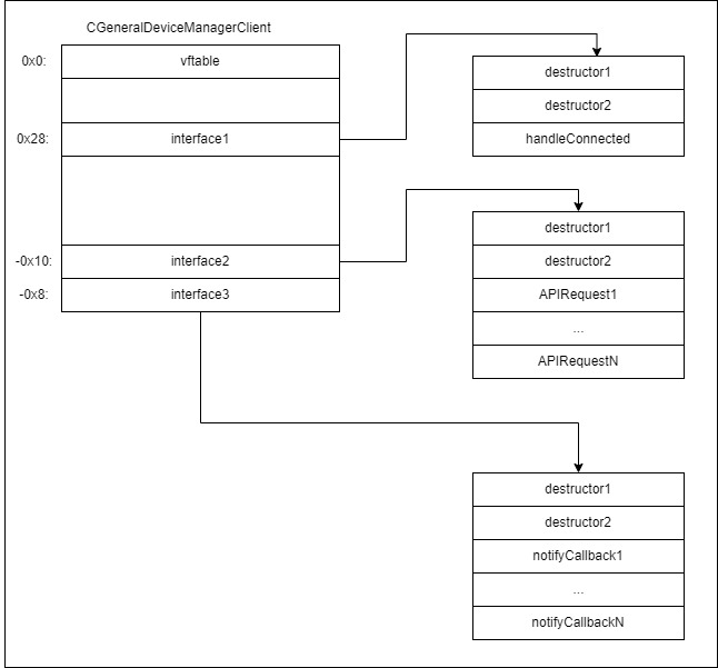

thriftme
This RPC protocol is based on the open-source protocol Apache Thrift. Its main distinctive feature is that thriftme allows subscribers to be notified about particular events. The UNIX socket, TCP, UDP, SSL, and so on can be used as a transport for this protocol. The core functionality of this protocol is implemented in the library libthriftme.so.2.7.2.

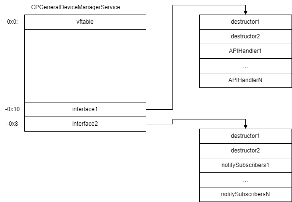

The base class in the thriftme RPC is “thrift::TServiceBroker”, which isolates the communication with transports and call interfaces of services and clients. In thriftme, the service broker version is the instance of “thrift::lisa::CTLisaServiceBroker”, which inherits from “thrift::TServiceBroker”.
Services in thriftme are inherited from “thrift::lisa::TLisaServerBase” (which, in turn, inherits from “thrift::TServiceProcessor”). Services are registered in the service broker through “thrift::TServiceProcessor::registerService”. Transport used by clients is registered through “thrift::lisa::CTLisaServiceBroker::addServers” (which wraps “thrift::TServiceBroker::addServer”). Service interface functions are registered through “thrift::TServiceProcessor::tmRegisterCallback”. The handler is passed to this export function in arguments, and it is called while processing the client request. So the instance of the service in memory looks as follows:
The “interface1” field contains functions which process the API of the service and their wrappers previously registered through “thrift::TServiceProcessor::tmRegisterCallback”. The “interface2” field contains functions which are called to notify subscribers of this service.
Clients in thriftme are inherited from “thrift::lisa::TLisaClientBase” (which, in turn, inherits from “thrift::TClient”). In fact, client instances are created by the service broker when the transport is successfully created. In our case, the service broker used the factory of a client, which is registered in the service broker through “thrift::TServiceBroker::tmRegCli”. The factory helps clients register handlers for notification about events through “thrift::TClient::tmRegisterCallback”. The sample instance layout of a thriftme client is the following:
The “interface1” field contains the handler is called after transport connection. Usually this handler is used to trigger a subscribe operation to receive event notifications. The “interface2” field contains functions which send requests to the service API. The “interface3” field contains functions which are called before initiating the “notify subscribers” operation of this service. Their wrappers were previously registered through “thrift::TClient::tmRegisterCallback”.

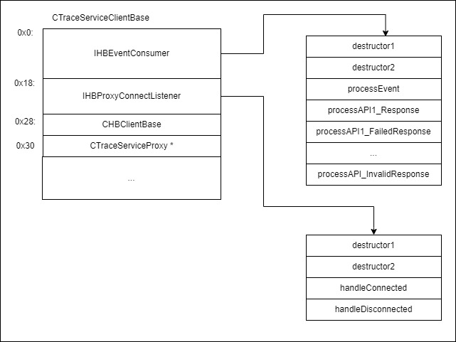

An example of a client object is “CTraceServiceClientBase”, which inherits from “CHBClientBase” and uses the proxy object “CTraceServiceProxy” for transport. The proxy object inherits from “CHBProxyBase” and is created through the factory method “CTraceServiceProxy::findOrCreateInstance”. It tries to reuse already created proxy objects inside this component. The general layout of a client object is as follows:
The “IHBEventConsumer” interface is used to process response events in “CTraceServiceClientBase”. The entry point for processing is the “processEvent” method. It uses two values to find a handler, which are called as follows:
- use the “status” field to identify the response: standard response of a service, failed or invalid response;
- use the “internalID” field to identify the API function.

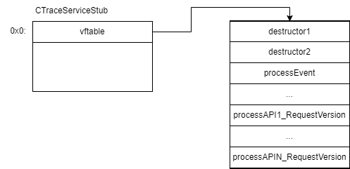

On the service side in our example we used the “CTraceServiceStub” class. Below is its layout:
The request event is processed in the “processEvent” method. It identifies the API function handler using the “internalID” field and calls the identified handler.

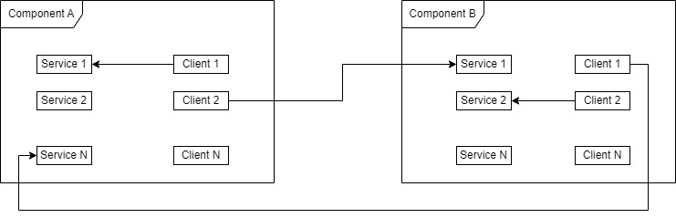

GCF
GCF is a custom protocol, which is used for RPC. It allows the services to be registered in the router. The router handles the following messages from services and clients:
- Control message (“CTRL”):
- “REGS” – used to register service;
- “REGF” – used to register RPC function of service;
- “EVNT” – used by service to notify clients about event;
- “CALL” – used by clients to call functionality of service;
- etc.
So during initialization, the services are registered in the router. The internal router table handles the flow of message processing. Finally, clients can send call requests to the router, which trigger predefined functions of registered services. The format of a call request is as follows:
CALL <ServiceName>:<Number> <ServiceCallName> <Params>

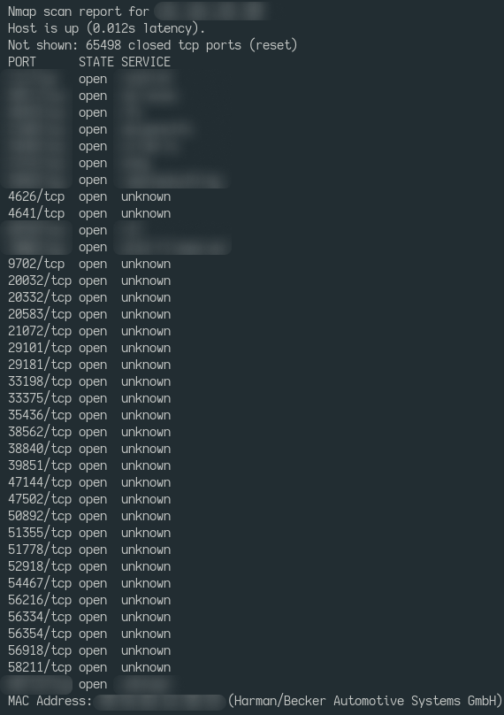

As mentioned in the KeenLab research, there are some test points on the head unit, which are used by the CSB for connection to the MMB. We removed the default connection and connected the RJ45 cable to access the internal network of the head unit. This connection, labelled as
eth0, has some restrictions, as stated in the corresponding firewall rules in “firewall_prd.policy”:
-A INPUT -s [IP]/32 -d [IP]/32 -i eth0 -m state –state NEW -j ACCEPT -A OUTPUT -s [IP]/32 -d [IP]/32 -o eth0 -j ACCEPT -A OUTPUT -s [IP]/32 -d [IP]/32 -o eth0 -m state –state NEW -j ACCEPT
Access to services on the MMB is established via an IP address, which is a default address for connecting the CSB to the MMB. The scan results of TCP ports on the MMB are as follows:
After connecting to the test point, we received a huge attack surface and access to the Diagnostic Log and Trace (DLT) subsystem, which is very helpful when testing and debugging:

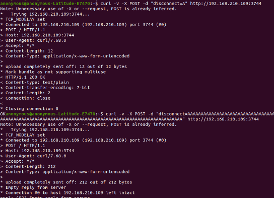

CVE-2024-37600 (MoCCA)
The “servicebroker” service is a part of a DSI framework, which is used in MoCCA. This service is used to monitor services and clients.
It sets up HTTP servers using TCP ports. There are several POST commands, which can be processed. One of them is
disconnect, which takes a string as an argument.

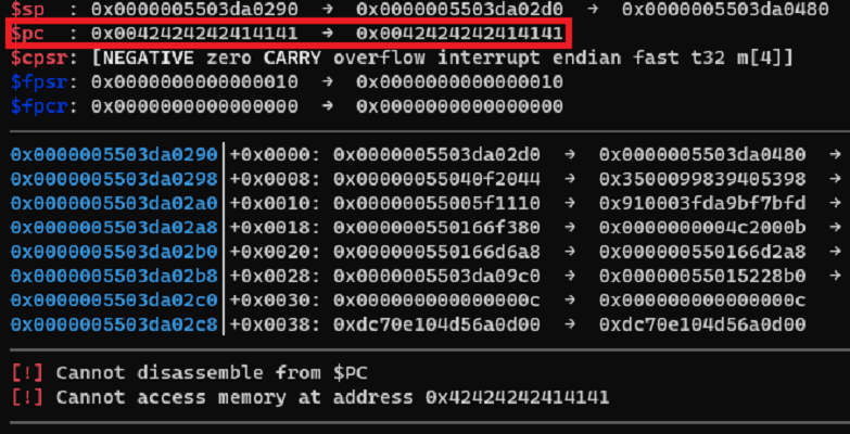

The code in the
setup()function tries to parse this command with functions that provide unnecessarily excessive access to memory. According to the disassembled code, it performs read operations using
sscanfon a stack buffer. As a result, there can be a stack buffer overflow:
In DLT logs we can identify crashes:

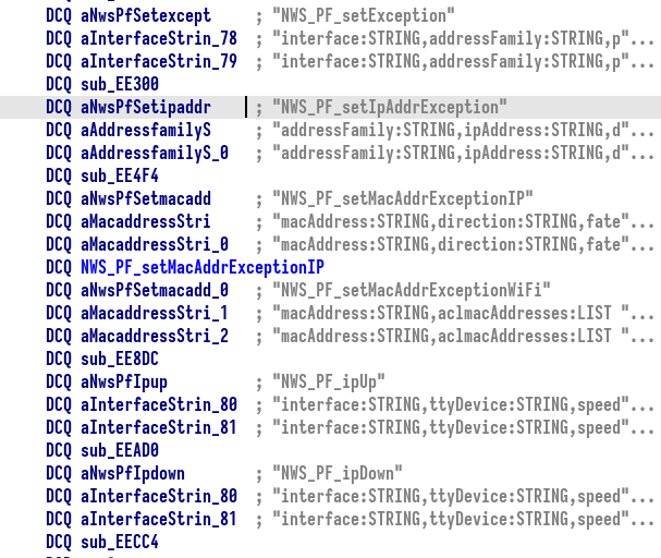

The list of registered services in the GCF router includes “NetworkingService”. It has the following registered handlers:
The “NWS_PF_setMacAddrExceptionIP” handler adds rules to the firewall policy. It uses the following arguments:
macAddress
– MAC address for the rule;direction
– defines the direction of rule: inbound or outbound;fate
– defines the type of rule: allow or deny;command
– the action to be performed: add the rule or remove it from the policy.
The control flow for processing this request is located in the following binaries: “MonitorService”, “libwicome_monitorservice.so” and “libwicode_gcf_core.so”. The call stack is the following:
sub_EE6E8 (NWS_PF_setMacAddrExceptionIP) sub_E9D0C (sNWS_PF_setMacAddrExceptionIP) sub_F275C (CGCFStub_PF::setMacAddrExceptionIP) sub_F7AF4 (CGCFStub_PF::_int_setMacAddrExceptionIP) snprintf sub_F7EB4 (systemExec) system
The
sub_F7AF4function executes the
system()call with arguments to the
iptablesbinary:
/* ... */ if ( v10 ) { v11 = (const char *)PAL::CString::raw(direction); v12 = (const char *)PAL::CString::raw(mac); if ( snprintf(v22, 0xFFuLL, "iptables -%s %s -m mac --mac-source %s -j %s ", (const char *)&v21, v11, v12, v20) < 0 ) { /* ... */ v18 = 0; } if ( v18 ) { if ( (unsigned __int8)systemExec(a1, v22) != 1 ) { /* ... */ return 0; } } } /* ... */
When processing the request, the MAC address is neither checked nor restricted. That means an attacker can perform command injection during the
iptablescommand execution.

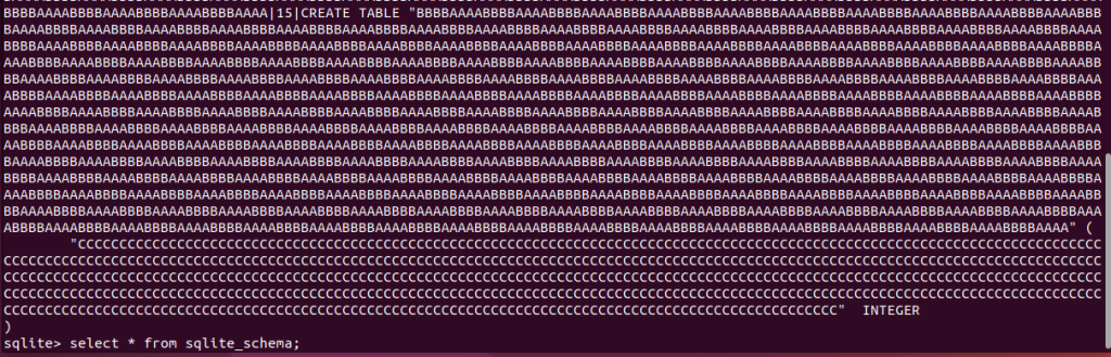

The backup contains XML files and binary files. Binary files are considered more useful for vulnerability hunting:
Data key | Filename in backup | Content |
PUD_COMMUTER | commuterroute.ud2 | ISO-8859 text, with no line terminators |
PUD_UAPREDICTIONSDATA | uapreds.ud2 | SQLite 3.x database |
PUD_VT_TUNER | vt_ab.ud2 | Proprietary binary data |
PUD_VT_ADDRESSBOOK | vt_tuner.ud2 | Proprietary binary data |

Lastly, the triggered vulnerability in the debugger looks as follows:
Thread 63 hit Breakpoint 2, 0x0000004002f3cea4 in ?? () # cid value (gdb) i r x2 x2 0xfffffffffffffffd -3 # cobject_id_vector size (gdb) x/1hx $x20 + 0x58 0x405c01b278: 0x000e # cobject_id_vector pointer (gdb) x/1gx $x20 + 0x60 0x405c01b280: 0x000000405c017f00 # 1 element in the cobject_id_vector (gdb) x/3gx *(void **)($x20 + 0x60) + 0 * 0x18 0x405c017f00: 0x000000400147f1c8 0x0000000000000000 0x405c017f10: 0x0000010000000002 # refferenced element (gdb) x/3gx *(void **)($x20 + 0x60) + -3 * 0x18 0x405c017eb8: 0x5f72696170766b5f 0x00315f656c626174 0x405c017ec8: 0x0000000000000035 (gdb) c Continuing.Thread 63 received signal SIGSEGV, Segmentation fault.
Exploitation notes
At the first stage, it is assumed that the image base address is fixed and the vulnerability code is loaded to a specific address in the memory. We analyzed the vulnerability code and checked exactly how all the pointers are dereferenced and where the virtual call is performed. Here are the steps:
- By controlling the id, we can move the pointer (by moving it to negative offsets relative to the beginning of the array in the heap);
- By moving the pointer, we will get to an address where another address containing an object for
bis_ptr
is located; - The address for
bis_ptr
should contain the address of the virtual call table.
Controlling only the offset to the corresponding object, we need to get to the address in the heap which contains a pointer to the pointer with the associated virtual table.
We can implement such a scenario using a spray of DDL entries inside the SQLite database that we can control. For such a spray, we need to create a lot of tables with long names. As a result, structures of a proper format will appear in the heap and a negative index will allow us to get to these structures.
Below is an example of such a SQLite-based file (the entry in
sqlite_schemais a table creation request):
So we can create a lot of tables with long names, which gives us a heap spraying primitive.
Using the heap spraying technique, an attacker can fully control the execution:
