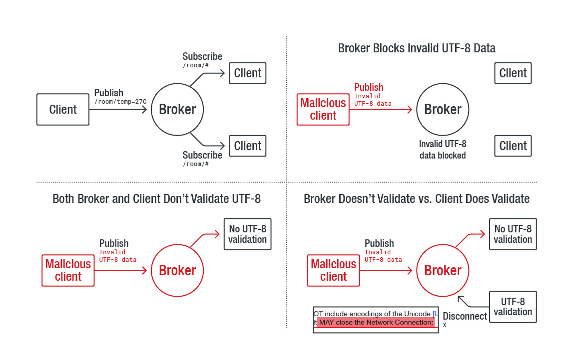

The MQTT standard has some corner cases that could subject implementations to vulnerabilities. One of the cases involves the Unicode handling in topic strings. The standard leaves it up to the developer to close the connection upon failing the validation of disallowed UTF-8 code points. So if it happens that a broker does not check for disallowed UTF-8 code points, a malicious client could take advantage of the discrepancy to disconnect other clients through invalidly encoded strings.
Context (top left); a broker that implements the check as in the standard (top right); both client and broker do not implement the check (bottom left); the broker lets the invalid character pass, while the client follows the standard (bottom right)
Figure 1. Context (top left); a broker that implements the check as in the standard (top right); both client and broker do not implement the check (bottom left); the broker lets the invalid character pass, while the client follows the standard (bottom right)
Of course, if the broker follows the standard, it wouldn’t be an issue. Interestingly, if both the broker and the client do not follow the standard, the issue is also avoided. But if the broker does not follow the standard and the client does, the client will disconnect upon receiving invalid content.

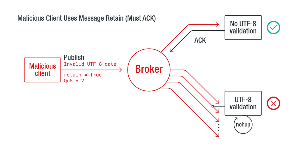

Figure 2. A malicious client could exploit the discrepancy between validating versus non-validating nodes to keep nodes offline. Notably, in this case, not following the standard appears as the best approach for a client.
If the broker does not follow the standard, a malicious client could keep all the clients offline with a single “retain message” set to true and the quality of service (QoS) to 2. The clients will then disconnect upon receiving the invalid message and not acknowledge back to the broker. This, in turn, will have the broker assume that the clients never received the message and thus will keep flooding them with the same retained message over and over because of the “retain message” and “QoS = 2”.

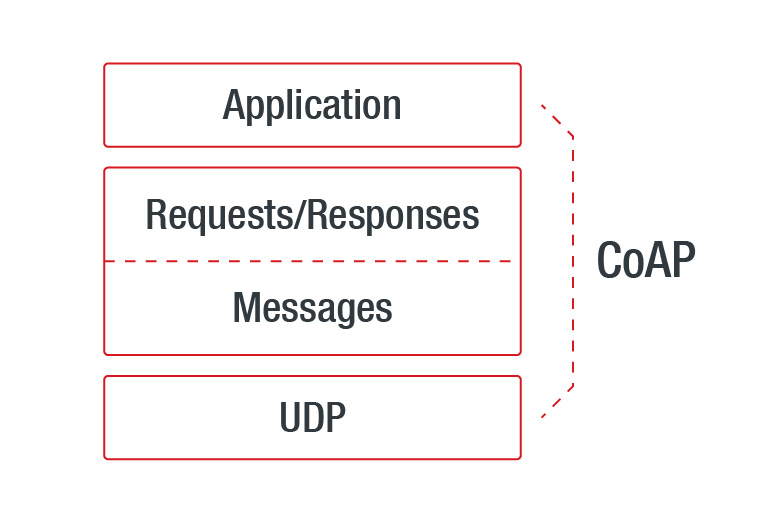

CoAP: IP address spoofing on UDP and the risk of amplification (PoC)
Figure 3. Abstract layering of CoAP,<br>based on a figure from a document by Internet Engineering Task Force (IETF)
As previously mentioned, CoAP is UDP-based, and thus inherently susceptible to Internet Protocol (IP) spoofing. Unlike transmission control protocol (TCP), UDP has no handshake phase, in which two endpoints agree on a sequence number that identifies a connection. This means that if an attacker sends a UDP packet with a spoofed source IP address to an endpoint, that endpoint will have no way to verify where the packet came from. This also means that if autonomous systems have no specific countermeasures against spoofing, an endpoint will have to trust the UDP packet header and act accordingly.
