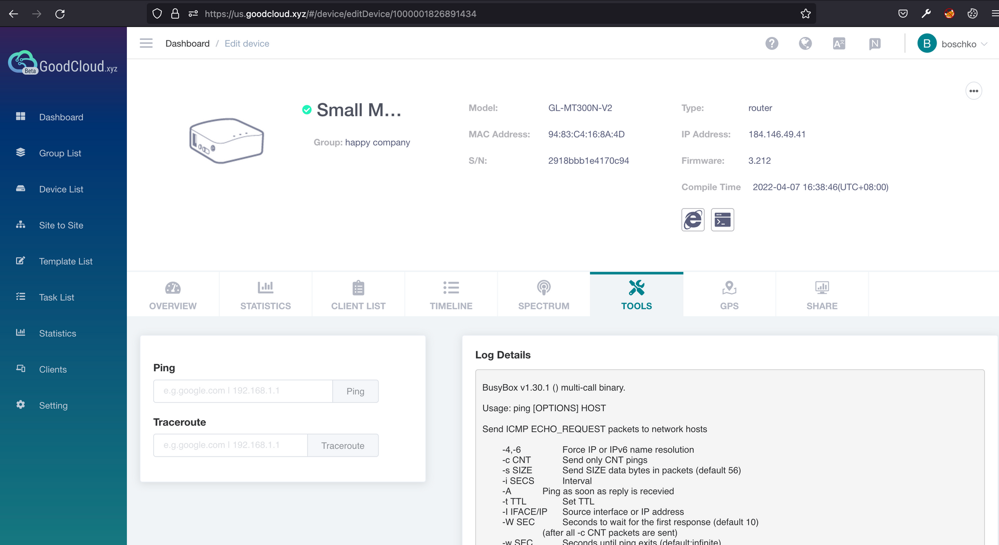

Enterprise users will have the TOOLS menu when editing their devices as seen below.
alt
The ping_addr and trace_addr both allow you to read any file on disk when prepending ;/bin/sh to the file you want to read.
alt
I'm not sure why this happens. I have not been able to get regular command injection due to the way its calling ping and traceroute within busybox from what I assume is data passing through something similar to a ngrok tunnel. I can't use funky delimiters or common escapes to simply comment out the rest of the operation. Anyhow, valid payloads would look like the following:
;bin/sh%20/<PATH_TO_FILE>
&bin/sh%20/<PATH_TO_FILE>
As a POC I’ve created a flag.txt file in /tmp on my router and I’m going to read it from the cloud gateway. I could just as easily read the passwd and shadow files. Successfully cracking them offline would allow me access to both the cloud ssh terminal, and the login UI.
alt
