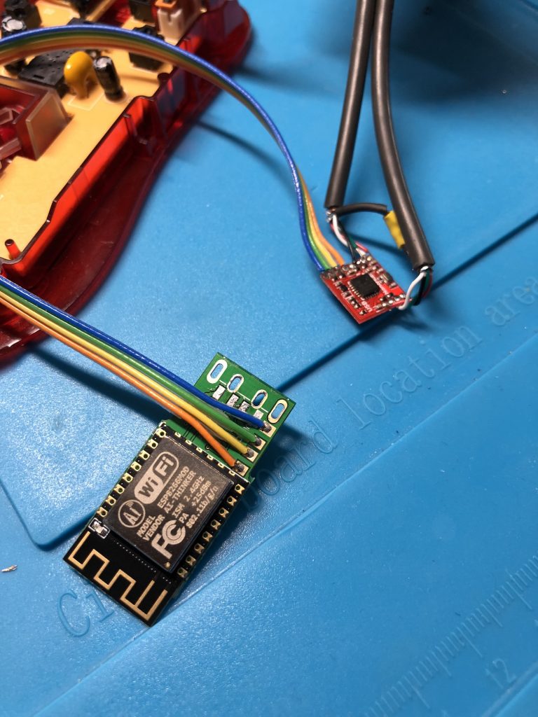

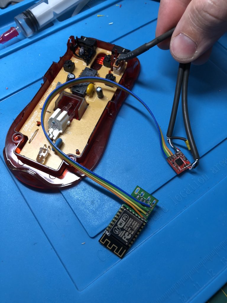

Hopefully, most USB mouses have enough inside space to hide extra cables and the WHID. To connect both USB devices on the same cable, I found a nano-USB hub with two ports:
Nano-USB Hub
This device does a perfect job only on a 12x12mm circuit! I bought a second WHID device and found an old USB mouse ready to be weaponized to start a new life. The idea is the following: cut the original USB cable and solder it to the nano hub then reconnect the mouse and the WHID to the available ports (to gain some space, the USB connector was unsoldered.
My soldering-Fu is not good enough to assemble such small components by myself so my friend @doegox made a wonderful job as you can see from the pictures below. Thanks to him!
Inside the Evil Mouse

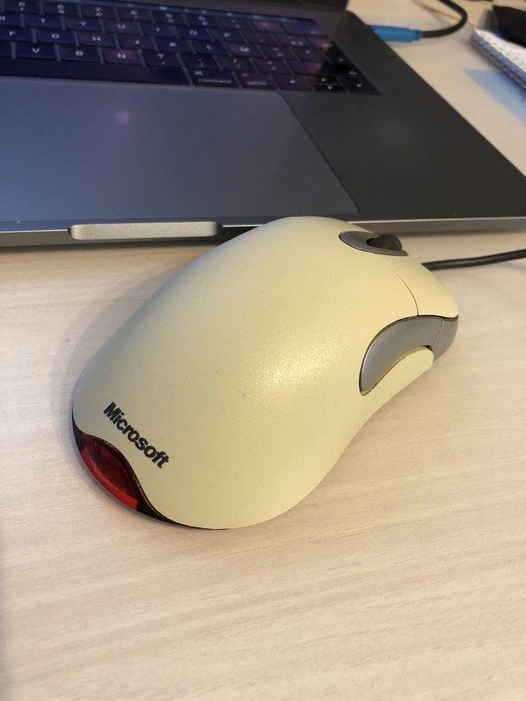

Once all the cables re-organized properly inside the mouse, it looks completely safe (ok, it is an old Microsoft mouse used for this proof-of-concept) and 100% ready to use. Just plug it in the victim’s computer and have fun:
Final MouseThe Evil Mouse
