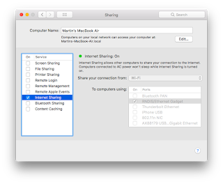

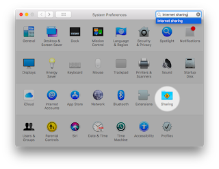

Or, you can turn on “connection sharing” in Windows or macOS. This sets up your laptop to NAT the Ethernet out through your laptop’s other network connection (such as WiFi). This also provides DHCP to the device. On my macBook, it assigns the RPi an address like 192.168.2.2 or 192.168.2.3.
System preferences -> Sharing
Allowing Ethernet devices to share WiFi connection to Internet
In the above example, the RPi is attached via my Thunderbolt Ethernet cable. I could also have used a USB Ethernet, or RNDIS Ethernet (described below).

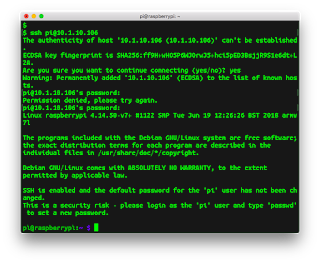

The default login for Raspbian is username pi and password raspberry. To ssh to the device, use a command line like:
$ ssh [email protected]
or
Some troubleshooting tips. If you get an error “connection refused”, that means the remote SSH service isn’t running. It has to generate a new, random, SSH key the first time it runs, so startup can take a while. I just waited another minute and tried again, and everything worked. If you get an error “connection closed”, then it borked generating a key on the first startup. The service is running, and allowing the connection, then closing it because it has no key to use. There’s no hope for things at this point other than reflashing the SD card and starting over from scratch, or logging in some other way and fixing the SSH installation manually. I had this problem happen once, I don’t know why, and ended up just starting over from scratch.

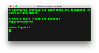

Also in that root directory you’ll find a file config.txt. Edit that file and add the line “dtoverlay=dwc2” to the bottom.
The dwc2 is a driver for the OTG port that auto-detects if the port should be in host mode (where you attach devices to the RPi like flash drives), or device mode (such when emulating Ethernet, serial ports, and so forth).

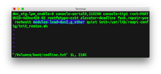

Also in the root directory you’ll find cmdline.txt. Edit that file. It has only one very long line of text (that’ll wrap terminal). Edit that line. Move the cursor to after nowait and add the text “modules-load=dwc2,g_ether”.
These are the Linux command-line boot parameters. This is telling Linux to load the dwc2 driver, and configure that driver for emulating an Ethernet adapter.

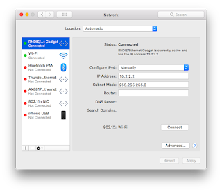

On macOS, go to the Network System Preferences. Wait a couple minutes for the RPi Zero to boot and you should see an “RNDIS” Ethernet device appear. I’ve given mine a manual IP address, though I don’t think it matters, because I’m going to use “Internet sharing” to share the connection anyway.
RPi0 should now appear as RNDIS device
By the way, “RNDIS” is the name Microsoft gave this virtual Ethernet adapter, based on the NDIS name for Ethernet drivers Microsoft first created in the 1980s. It’s the name we use on macOS, Linux, BSD, Android, etc.
I struggled getting the proper IP address on this thing and ended up using Internet sharing, as described above, for this. The only change was to share the RNDIS Ethernet instead of Thunderbolt Ethernet.
Use NAT/DHCP to allow RPi0 to share my laptop’s WiFi

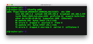

The Ethernet interface will come up with the name usb0.

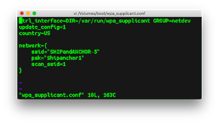

Now we to create a file in the SD root directory called “wpa_supplicant.conf” with contents that look like the following:
ctrl_interface=DIR=/var/run/wpa_supplicant GROUP=netdev
update_config=1
country=US
network={
    ssid=“YOURSSID”
    psk=“YOURPASSWORD”
    scan_ssid=1
You need to change the SSID and password to conform to your WiFi network, as I do in the screenshot below (this is actually the local bar’s network):

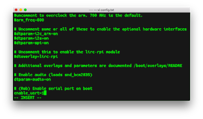

The next step is to edit config.txt on the SD card and add the line at the end “enable_uart=1”.

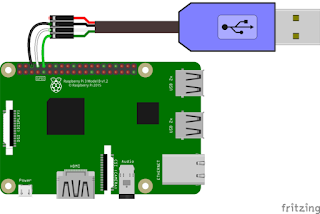

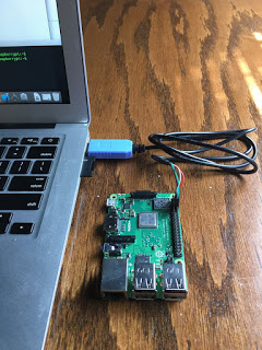

First, let’s hook the serial cable to the Raspberry Pi. NOTE: don’t plug in the USB end into the computer yet!!! The guide at Adafruit shows which colored wires to connect to which GPIO pins.
From Adafruit
Basically, the order is (red) [blank] [black] [white] [green] from the outer edge. It’s the same configuration for Pi Zeroes, but you may get yours without pins. You either have to solder on some jumper wires [] or use alligator clips.
You have two options on how to power the board. You can either connect the red wire to the first pin (as I do in the picture below) or you can connect power as normal, such as to a second USB port on your laptop. I chose to try the serial cable to power my Raspberry Pi 3 Model B+ from the serial port. I got occasional messages complaining about “undervoltage”, but everything worked without corrupting the SD card (SD card corruption it often what happens with power problems).
Once you’ve got the serial cable attached to the Pi, then plug it into the USB port on the laptop. This should start booting up.

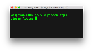

$ sudo screen /dev/cu.SLAB_USBtoUART 115200
You’ll have to hit the return key a couple times for it to know you’ve connected, at which point it’ll give you a command prompt.
(I’ve renamed the system from ‘raspberrypi’ in the screenshot to ‘pippen’).
