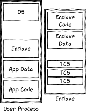

The implementation of Intel SGX can be summarized in a few points:
  • an application is split into two parts: a secure one and a non-secure one;
  • the application launches the enclave, which is placed in protected memory;
  • when an enclave function is called, only the code within the enclave can see its data, external accesses are always denied; when it returns, enclave data stays in the protected memory.
The secure execution environment is part of the host process, which means that:
  • the application contains its own code, data, and the enclave;
  • the enclave contains its own code and its own data too;
  • SGX protects the confidentiality and integrity of the enclave code and data;
  • enclave entry points are pre-defined during compilation;
  • multi-threading is supported (but not trivial to implement properly);
  • an enclave can access its application's memory, but not the other way around.

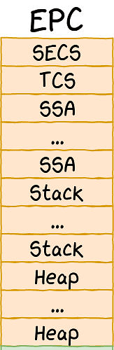

Enclave Page Cache (EPC)

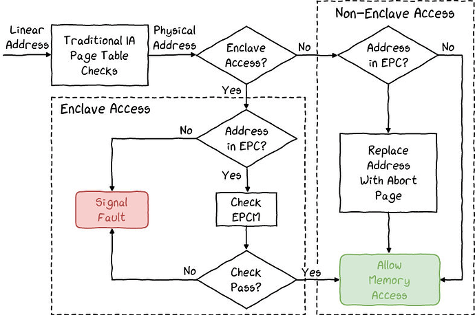

Enclave code and data are placed in a special memory area called the Enclave Page Cache (EPC). This memory area is encrypted using the Memory Encryption Engine (MEE), a new and dedicated chip. External reads on the memory bus can only observe encrypted data. Pages are only decrypted when inside the physical processor core. Keys are generated at boot-time and are stored within the CPU.
The traditional page check is extended to prevent external accesses to EPC pages.
Enclave Page Cache Map (EPCM)
The Enclave Page Cache Map (EPCM) structure is used to store the pages state. It is located inside the protected memory and its size limits the size of the EPC (set by the BIOS, 128MB maximum). It contains the configuration, permissions and type of each page.

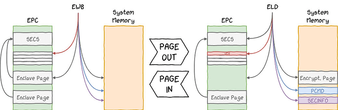

EPA - This instruction allocates a 4KB memory page that will contain the pages version number array (VA) to protect against replay. Each element is 64 bits long.
EBLOCK - This instruction blocks all accesses to the page being prepared for eviction. All future accesses to this page will result in a page fault ("page blocked").
ETRACK - This instruction evicts a page from the EPC. The page must have been prepared properly: it must be blocked and must not be referenced by the TLB. Before writing it into the external memory, the page is encrypted, and a version number and meta-data are generated, and a final MAC is performed.
ELDB/ELDU - This instruction loads into memory a previously evicted page, in a blocked state or not. It checks the MAC of the meta-data, version number (from the corresponding VA entry), and the page encrypted content. If the verification succeeds, the page content is decrypted and placed inside the chosen EPC page, and the corresponding VA entry deleted.
Explanations
The EPC memory is defined by the BIOS and limited in size. SGX has a way for removing a page from the EPC, placing it in unprotected memory, and restoring it later. Pages maintain the same security properties thanks to the EPC pages management instructions, that allow to encrypt an page and produce additional meta-data. A page cannot be removed until all cache entries referencing this page have removed from all processor logical cores. Content is exported or imported with a granularity of a page (which is 4KB).

SGX Enclave Control Structure (SECS)
Each enclave is associated with a SECS structure, which will contain its meta-data (e.g. its hash and size). It is not accessible to any secure nor non-secure code, only by the processor itself. It is also immutable once instantiated.
Thread Control Structure (TCS)
Each enclave is associated with at least a TCS structure, which indicates an execution point into the enclave. As SGX supports multi-threading, an enclave can as many active threads as it has TCS. Like the SECS structure, it is only accessible by the processor, and is also immutable.
Save State Area (SSA)
Each TCS is associated with at least a SSA structure, which is used to save the processor's state during the exceptions and interruptions handling. It is written when exiting, and read when resuming.
Stack and Heap
Each enclave can use its stack and heap. The RBP and RSP registers are saved when entering and exiting, but their value is not changed. The heap is not handled internally, enclaves need their own allocator.

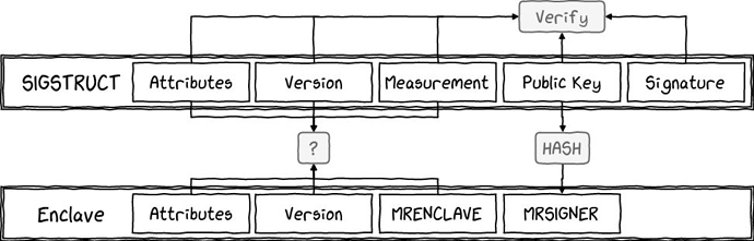

Each enclave is represented by a hash of both its attributes and the position, content and protection of its pages. Two enclaves with the same hash are identical. This measure is called MRENCLAVE and is used to check the integrity of the enclave.
Signer Measure
Each enclave is also signed by its author. MRSIGNER contains the hash of the public key of the author. MRENCLAVE and MRSIGNER are produced using the SHA-256 hash function.
Structures
EINIT Token Structure (EINITTOKEN)
The EINITTOKEN structure is used by the EINIT instruction to check if an enclave is allowed to execute. It contains the attributes, hash and signer identity of the enclave. It is authenticated using a HMAC performed with the Launch Key.
Enclave Signature Structure (SIGSTRUCT)
Each enclave is associated with a SIGSTRUCT structure, which is signed by its author and contains the enclave measure, signer public key, version number (ISV, reflecting the security level) and product identifier (ISVPRODID, to distinguish between enclaves from the same author). It allows to ensure that the enclave hasn't been modified and then re-signed with a different key.

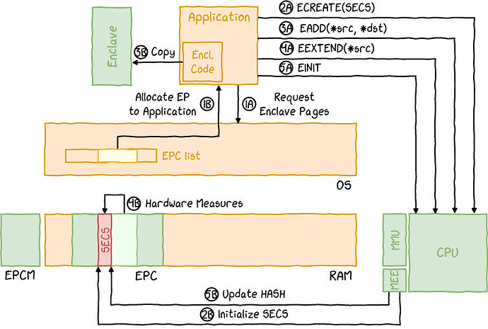

ECREATE - This instruction instantiates a new enclave, defining its address space and root of trust. Those informations are stored in a newly allocated SECS.
EADD - This instruction allows to add a new page to the enclave. The operating system is solely responsible for choosing the page and its content. The initial entry for the EPCM denotes the page type and its protection.
EEXTEND - This instruction allows to add a page's content to the enclave measure, by block of 256 bytes. It must be called 16 times to add a complete page to the measure.
EINIT - This instruction checks that enclave corresponds to its EINITTOKEN (same measure and attributes) before initializing it. It also checks that the token is signed with the Launch Key.
EREMOVE - This instruction removes permanently a page from the enclave.
Explanations
  1. The application requests the loading of its enclave into memory;
  2. The ECREATE instruction creates and fills the SECS structure;
  3. Each page is loaded into protected memory using the EADD instruction;
  4. Each page is added to the measure of the enclave using the EEXTEND instruction;
  5. The EINIT instruction finalizes the enclave creation.

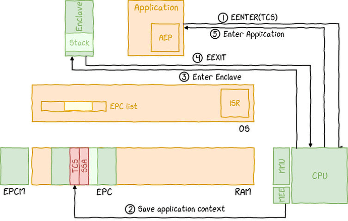

EENTER - This instruction transfers the control from the application to a pre-determined location within the enclave. It checks that the TCS is free and purges the TLB entries. It then puts the processor in enclave mode and saves the RSP/RBP and XCR0 registers. Finally, it disables the Precise Event Based Sampling (PEBS) to make the enclave execution appear as one giant instruction.
EEXIT - This instruction puts the process back in its original mode and purges the TLB entries for addresses located within the enclave. Control is transferred to the address located within the application and specified in the RBX register, and the TCS structure is freed. The enclave needs to clear its registers before exiting to prevent data leaks.
Explanations
Enclave Entry
  1. EENTRY instruction is executed;
  2. The application context is saved;
  3. The processor is put in enclave mode.
Enclave Exit
  1. EEXIT instruction is executed;
  2. The processor is put in normal mode.

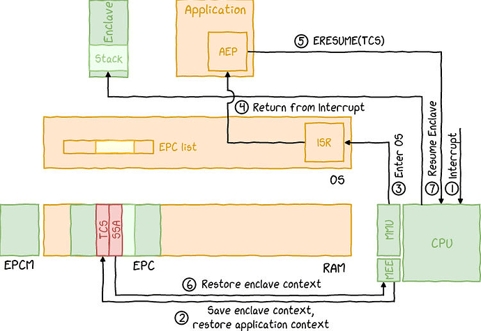

ERESUME - This instruction restores the context from the current SSA and resume the execution.
Explanations
Interruptions and exception result in Asynchronous Enclave Exits (AEX). The Asynchronous Exit Pointer (AEP) points to a handler located inside the application that will resume the execution after the exception has been handled by the Interrupt Service Routine (ISR). The handler can decided to resume or not the execution of the enclave, by executing the ERESUME instruction.
When an AEX happens, the context of the enclave is saved in the current SSA and the application context is restored. The enclave context is restored when the ERESUME instruction is executed. The TCS contains a counter denoting the current SSA, forming a stack of contexts.
Handling an Interruption
  1. The interruption or exception arrives to the processor;
  2. The enclave context is saved, the application context is restored;
  3. The execution continues in the handler of the operating system;
  4. The handler returns (IRET) to the AEP, a trampoline function;
  5. AEP execute ERESUME if it decides to resume enclave execution;
  6. The enclave context previously saved is restored;
  7. The execution resuming where it stopped within the enclave.

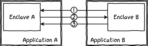

Local Attestation
  1. A channel must have already been established between enclave A and enclave B. It is used by enclave A to retrieve the MRENCLAVE of B.
  2. Enclave A calls EREPORT with the MRENCLAVE of B to generate a signed report for the latter.
  3. Enclave B calls EGETKEY to retrieve its Report Key and verify the MAC of the EREPORT structure. If valid, the enclave is the one expected and running on a legitimate platform.

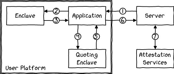

Remote Attestation
Remote attestation requires an architectural enclave called the Quoting Enclave (QE). This enclave verifies and transforms the REPORT (locally verifiable) into a QUOTE (remotely verifiable) by signing it with another special key, the Provisioning Key.
  1. Initially, the enclave informs the application that it needs a secret located outside of the platform. The application establishes a secure communication with a server. The server responds with a challenge to prove that the enclave executing has not been tampered with and that the platform it executes on is legitimate;
  2. The application gives the Quoting Enclave identity and the challenge to its enclave;
  3. The enclave generate a manifest including the challenge answer and an ephemeral public key that will be used later to secure the communications between the server and the enclave. It generates a hash of the manifest that it includes in the user data section of the EREPORT instruction. The instruction generates a REPORT for the Quoting Enclave that ties the manifest to the enclave. The enclave passes the REPORT to the application.
  4. The application transfers the REPORT to the Quoting Enclave for verification and signing.
  5. The QE retrieves its Report Key using the EGETKEY instruction and verifies the REPORT. It creates the QUOTE structure and signs it using its Provisioning Key before giving it back to the application.
  6. The application sends the QUOTE and associated manifest to the server for verification.
  7. The server uses the attestation service provided by Intel to validate the QUOTE signature. It then checks the manifest integrity using the hash from the QUOTE user data. Finally, it makes sure that the manifest contains the expected answer to the challenge.
