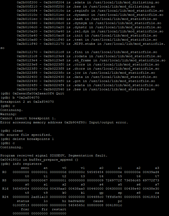

3 - Persistent webui DOS potentially exploitable
An UNAUTHENTICATED POST request to /goform/langSwitch exposes the device to a permanent segmentation fault with a very long string in the paramenter named langSelectionOnly="IT[.....]TTT" (3894 char) . The device will be soft "bricked", until a physical reset! LOLThis may be exploitable, more investigation needed.

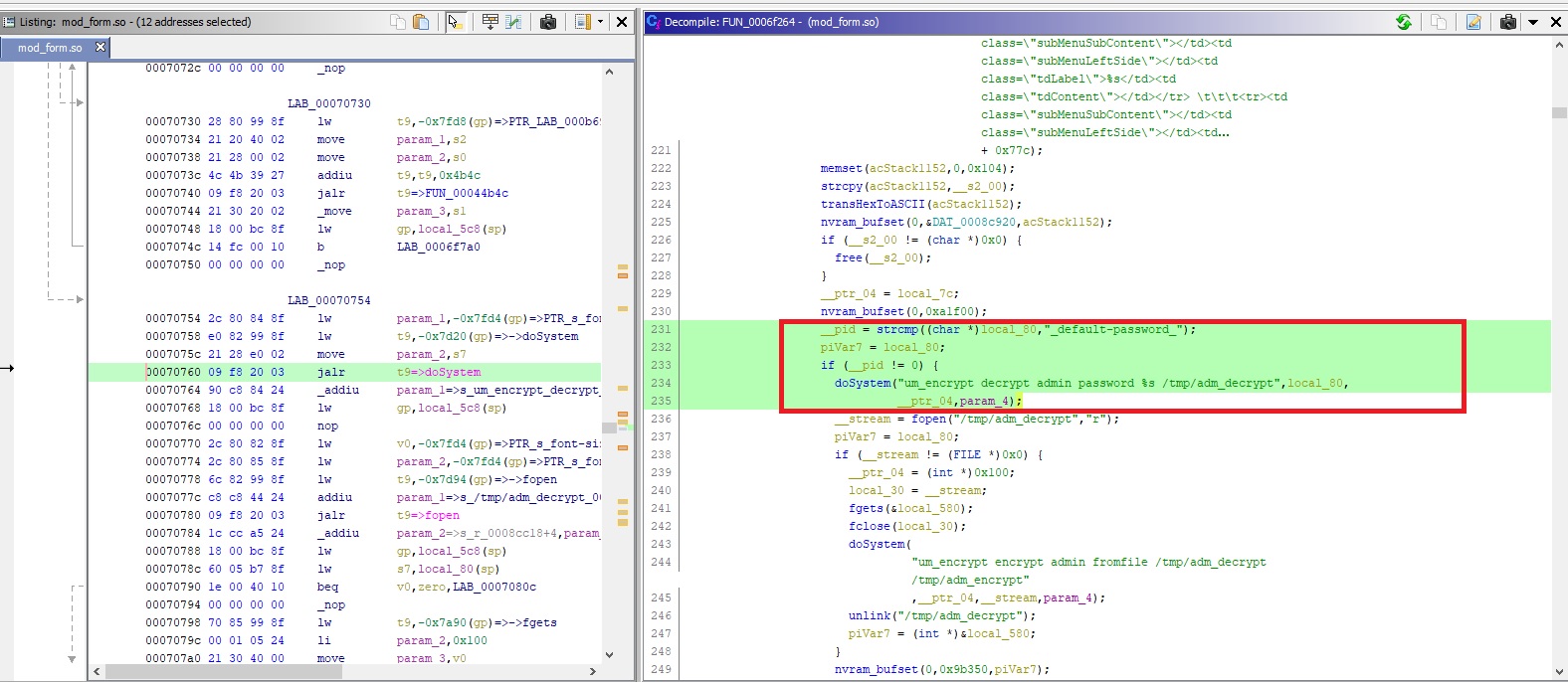

4 - Unauthenticated RCE
Without any authorization checks, the webpage /goform/setSysAdm execute its own code!To make matters worse, the
admpass
parameter can be our attack vector to manipulate the system() call that follows.local_80 variable is our admpass parameter.
There are different ways to perform a code injection.
The most comfortable to me was to split the hardcoded command "um_encrypt decrypt admin password %s /tmp/adm_decrypt" executed by doSystem("");* into a multiple -3 -commands by using semicolons: "um_encrypt decrypt admin password ; mycode injected here ; /tmp/adm_decrypt" the first and the last commands go wrong doing nothing, but the middle injected code will be executed correctly leading us to achieve the goal.
By doing this wild injection, we broke the router standard behaviour that will start the telnet daemon, but will not guarantee future access because the user's password tampering.
But, since the vulnerability lies precisely in the password change parameter, which can be used without authentication, we'll use the same webpage to set a new password.
Here is the final POC:
