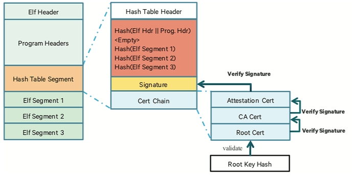

These features are available as signed third-party applications (called trustlet), and are securely loaded and executed in Secure World by the operating system running in TrustZone (the SecureOS).
One of these secure loading features (namely the Qualcomm one) was fully retro engineered by Gal Beniamini, before Qualcomm made it pubic.
The trustlet integrity checking process is relatively standard and consists of a hash table, each hash represents the hash of a segment of the ELF binary. This hash table is then signed by the trustlet issuer, and this signature can be verified through a certificate chain placed directly after the signature. This chain of trust can be validated thanks to the root certificate of which a SHA256 is placed in a fuse (QFuse), ensuring its integrity.
Source: Qualcomm

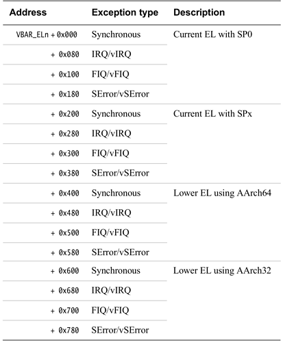

Exception handling in ARMv8
In ARMv8, a new exception model has been introduced which defines the concept of exception levels. An exception level determines the privilege level (PL0 to PL3) at which software components run and which processor modes (non-secure and secure) shall be used to run it. Execution at ELn corresponds to privilege PLn and, the greater the n is, the more privileges an execution level has. When an exception occurs, the processor branches to an exception vector table and runs the corresponding handler. In ARMv8, each exception level has its own exception vector table.
Secure Monitor Calls (SMC) generate synchronous exceptions handled by the handler stored at VBAR_EL3 + 0x600 (Synchronous EL3 exception handler)
