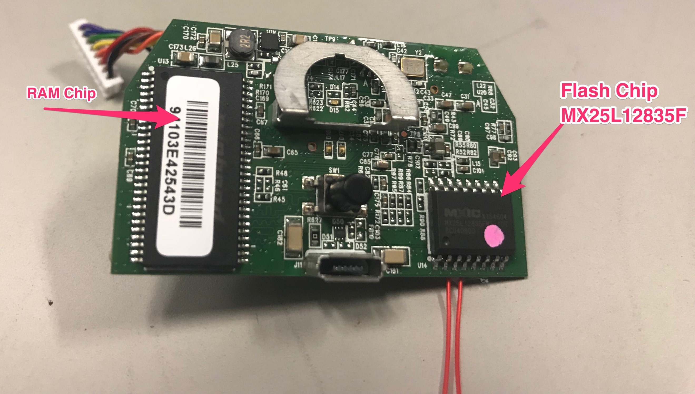

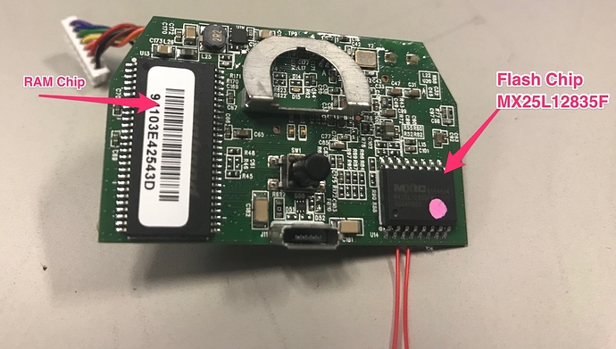

We turned to the hardware and disassembled the device. We identified chips on the main board, found headers for communicating with the device, and pulled the memory off flash. Our online research provided datasheets for each of the chips on the board.

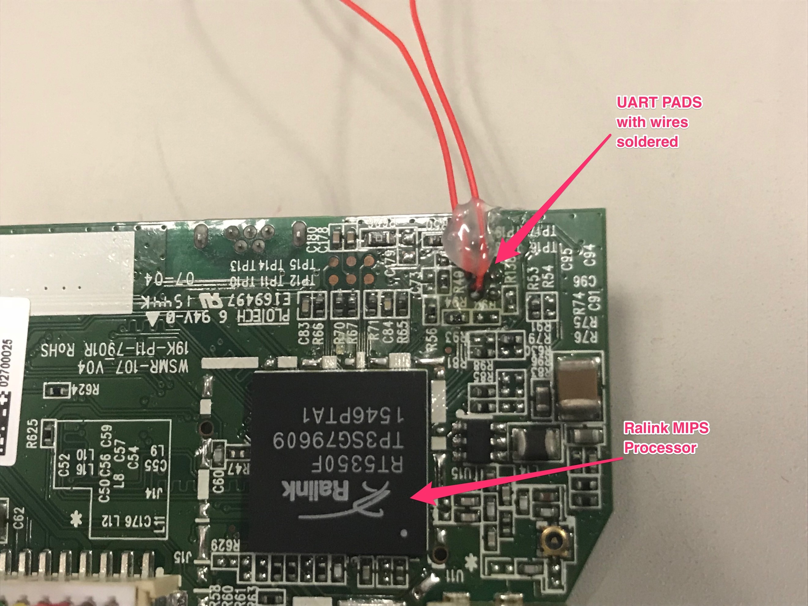

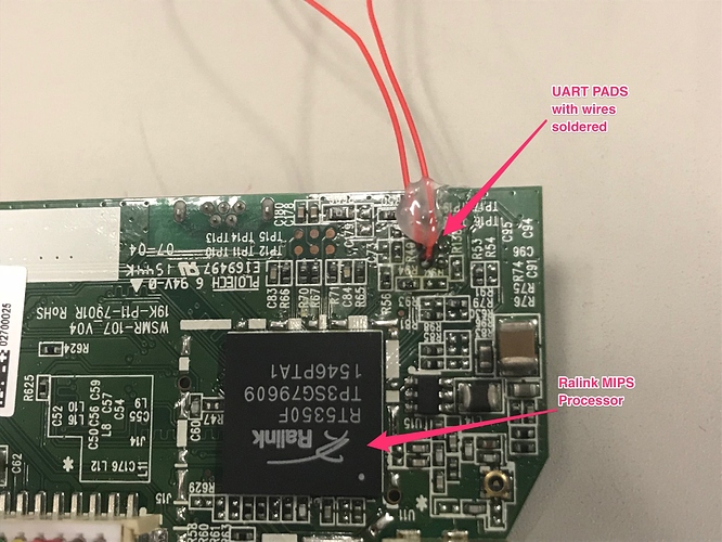

We found universal asynchronous receiver-transmitter (UART) pads on the board and confirmed them with the documentation. We soldered wires to these headers to discover if they were actively transmitting. To test communication with the device, we used an Exodus XI Breakout board, shown below:
After brute-forcing the baud rate, we were able to get debug information via the UART interface. The UART also provided a login prompt; however, neither online research nor simple guessing led us to a working password.
Extraction and firmware analysis
The flash chip discovered on the board was a Maxronix MX25L12835F, which is supported by flashrom, a well-known open-source tool for extracting firmware. Using flashrom and the XI Breakout board, we extracted the firmware from the Wemo device. After we obtained the original firmware image shipped with the device, we updated it using the Wemo mobile application. Once the device was updated, we again extracted the firmware from the device, providing us with a second image. We ran basic sanity checks with the new firmware to ensure our earlier software reconnaissance had not changed.
With the firmware extracted, we analyzed the firmware using binwalk, an open-source binary analysis tool. Binwalk extracted the file system from the firmware for further inspection. Access to the file system allowed us to review system configuration and access binaries.

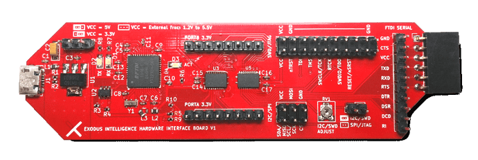

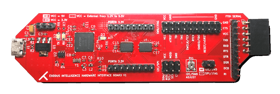

With a new firmware binary in hand, we used the XI Breakout board and flashrom to write the firmware to the flash chip on the board. After rebooting the device, we were able to log in using the new password.

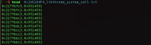

We still face a major challenge: Only addresses comprising entirely ASCII characters can pass through the XML filter. This drastically limits the potential for finding usable gadgets. We used IDA to see where libc and system are loaded into memory, and found two implementations: in libuClibc-0.9.33.2.so at address 0x2B0C0FD4; and in libpthread-0.9.33.2.so at address 0x2AD104F4. However, neither of these addresses meet the requirements to pass through the XML filter. Thus even if we could create an ROP chain, we would not be able to send just the address for system in the packet.
Addresses with bad characters are not a new problem for exploit development. One of the most common bypasses is to use addition or subtraction ROP gadgets to create the required address in a register and call that register. Again, however, we face the limitation on which operands can be used for this addition or subtraction equation due to the XML filter.

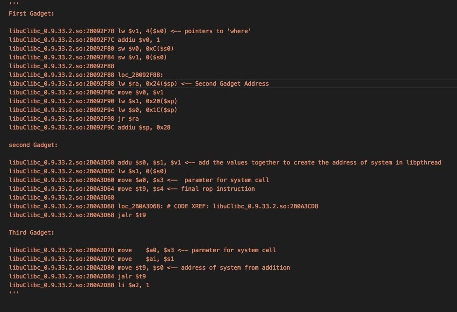

After studying the memory layout, we discovered that libuClibc-0.9.33.2.so sits at a memory location with addresses that can bypass the XML filter. We were fortunate that this is a large library, providing a decent list of addresses, because it is the only library in such a space. With this discovery, the team created a tool to assist with the creation of this exploit. The tool pulls out all possible ROP gadgets with usable memory addresses and determines if an addition or subtraction equation could call one of the two system calls found in memory, using only the values that will bypass the filter. The address for system in libuClibc-0.9.33.2.so, 0x2B0C0FD4, did not have any usable operands. However, 0x2AD104F4 did. We found several “filter-proof” operands that when added together equaled 0x2AD104F4.
We employed our tool’s output for all possible ROP gadgets that bypass the filter to build an ROP chain, which uses an addition instruction to create the final address for system and stores it in $s0. After the addition, another gadget moves the address for system into $t9 and calls system. This final gadget also moves an address that can be controlled from the stack into the register holding the parameter for the system call. The entire ROP chain consists of only three gadgets, which easily fit in the stack space provided by the buffer overflow.
Piecing everything together
Earlier we discovered two attack techniques that can be used with this vulnerability: a write-what-where, and overwriting the return address on the stack. Each packet sent can use each technique once. To get a parameter to the system call, we must use write-what-where to place the parameter in a writable memory address and pass this address to system. Fortunately, this vulnerable application sets aside a large amount of writable memory that is never used, and in a range accessible to our limited set of addresses that bypass the filter. Unfortunately, the ROP chain that calls system requires the use of write-what-where to handle extra instructions in one of the ROP gadgets. This means that two packets are required to execute the exploit: one to write the parameter for system into memory, and a second to make the call to system. Thus it is important that the first packet exits cleanly and does not crash the program.
One way to execute cleanly is to use three well-placed pipes (“|”) inside the payload to stop writing and exit TokenParser at the appropriate time. It is also important to not overwrite the RA pointer so the program can continue normal execution after the packet is received. Then the second packet is sent containing the ROP chain calling system with the address of the parameter written by the previous packet.
